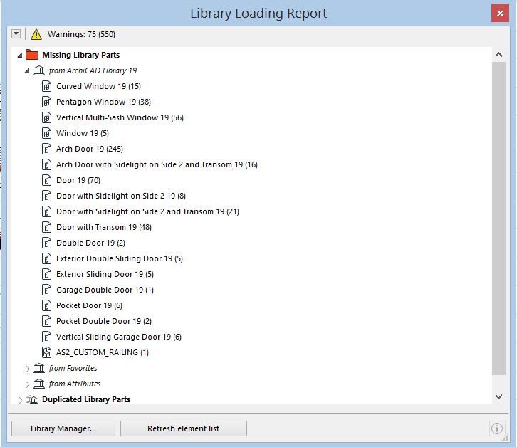

Here's the Library Loading Report
OK we can see you missing library parts and also that you have duplicated library parts.
Can you please show a screen shot of the loaded libraries as well?
loaded libraries
I can't quite see from your image but I assume the migration library that is loaded is the 19 migration library?
Do the doors have anything to do with the missing ASU library (I am not familiar with this one).
If the door come from there than that is why they are missing.
Or you could try as David suggested.
Delete the 20 library and the migration library and load just the 19 library.
If that works then there is a problem with the migration library.
If it doesn't work then I would guess the doors are in the ASU library.

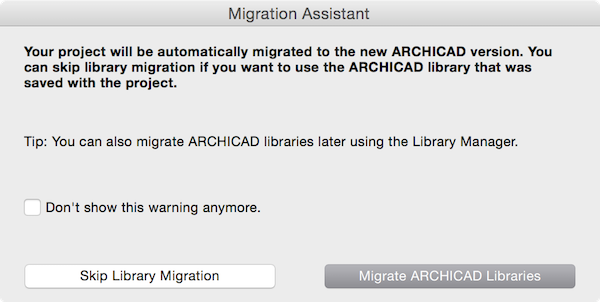

Did you use the Migration Assistant when opening the file?
