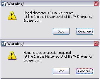

Rod - thank you very much for your help
The library that you attached is working with no errors on my side.
The window behaves normally - although there are two issues that I can't seem to solve:
- when I put the window on a wall, on the plan I have no lines between the wall and the window's frame - is there a way to have lines the same type as the outline lines of the wall?
- there are drop-down menus in the parameters of the window that seem to have turned into input fields
if I manually write what I need - it works fine - is that the way it should be?

Rod - the problem is I dont have this 'wall contours' selection in my parameters section of the properties of the window that loads from the library you gave me.
I see you work on a Mac, so I thought maybe this has got something to do with it - my systems are Vista and XP.
I tried to extract from my ArchiCAD 8 library the same files [or most of them] as the ones you have in your library.
Loading them this way unfortunately it still gives me the same error as it did when I tried to use it loading the whole ArchiCAD 8 library in ArchiCAD 11.
What was interesting was the fact that loading it this way it does display the 'wall contours' selection in the parameters section.
Maybe this setting is OS specific and can not be used across systems?
Since you said the GDL script for version 8 was not as complicated as for 11 - maybe you could make out something of the error messages it gives me when I load that same window from my ArchiCAD 8 library?
ps
Dropdown selection menus in the parameters still turned into input boxes... I guess libraries on Windows don't mix versions as smoothly or need extra modifications.
Shouldn't make any difference. I am regularly dealing with the "Dark Side" without any overt difficulty.
Line 2 is commented out in the master script, so should not show.
Puzzling!!
This should not be the case, and cannot work it out as everything works smoothly at my end.

Rod Jurich
AC4.55 - AC14 INT (4204) |  | OBJECTiVE |
Rod Jurich
Vic, try this window, I've changed all the "illegal characters" in the master script.
The default wall contours are set to show reveal lines.
Fingers crossed
Finally, try opening a new file in 11 with just this window and
associated macro folder loaded, nothing else, and let us know
what happens.

Rod - thank you very much for your help and responsiveness.
Thanks to your guidance I found a solution.
So here is what I did:
I made a pla file from ArchiCAD 9 [with ArchiCAD 8 library loaded] with one wall and the window in it.
I opened the pla file, selecting 'extract library to folder' in ArchiCAD 11 - the window appeared as a black dot in the wall, and gives the errors I attached earlier if it's properties are accessed.
Then I loaded the first library that you gave me - it gives duplicate library parts.
I place another window, next to 'the dot', this time using your library object.
And voila! Now I have the wall contours selection AND drop down menus in the parameters window of that second window!
I delete the corrupt window and unload its library, leaving your library loaded.
I save this first as pln then as pla file in ArchiCAD 11, then load the pla selecting 'extract library to folder'.
Now if I load this library on a blank ArchiCAD 11 file - the window works fine but there are no drop down menus.
And if I open the pln file that I saved from ArchiCAD 11 as pln - the same library object has drop down menus.
If I make a new project after I had the 'working' pln file open selecting 'use the last settings' - again - there are drop down menus
I guess some options in the properties of the library objects depend somehow on other information, that can be transferred from the mystery 'last settings' selection...
Anyway - I have no problem using that 'latest settings' option on every new project so again - thank you very much for your help
As for the last library you attached - it gives the following error:
Can't find Macro:trimmyboy, called at line 140 in the 2D script of the file W Emergency Escape.gsm

Now with the missing parts loaded - there are no errors, but still no drop down menus.
Even if I load with the 'last settings' option.
Anyway - I have it working now the way I described - thank you very much again for your help and time Rod.
