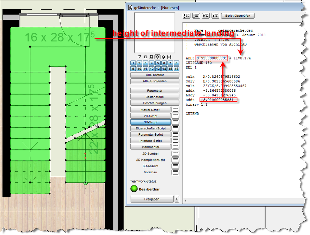

Nice trick, I did not think of that possibility.
Frank Beister
Holy moly, Laszlo, where are you, that you post at this time? 😉
Really nice trick! To avoid SEO operations, you can modify the 3D script of the object like in the attached screenshot.
