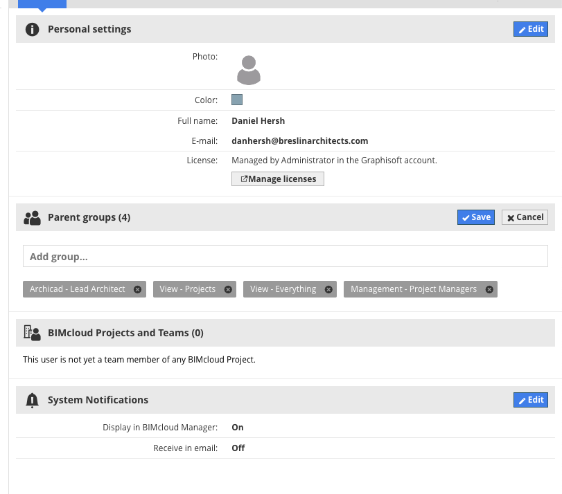

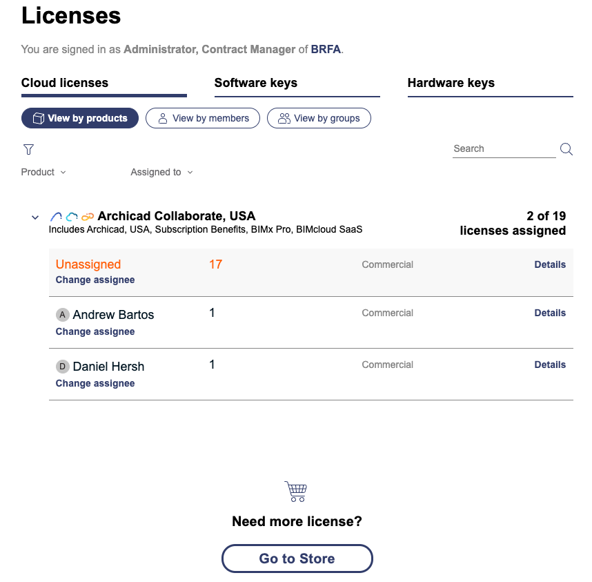

   I started to assign licenses and began by assigning a license to one user. I did this by going to my company page, selected the user, and clicked on assign new. Now by this users name it has Archicad Collaborate, USA, Commercial license type and lists all that the user has access to including BIMcloud SaaS.
   The user has received an email message stating that the new product is ready to use and clicks on the "Get Started" button. He then signed into his Graphisoft account that was setup by accepting his invitation sent by the administrator of the Company account. He clicked on manage account, selected licenses, and at Company License Tool it states "no license assigned to you." When trying to sign into the BIMcloud, a message says that he has successfully signed into his Graphisoft account, but he doesn't have a BIMcloud license yet.
   Is there something else I have to do in the Manager or company store or anything else the user has to do to show that he has been assigned a license and can access the BIMcloud. Thanks in advance.

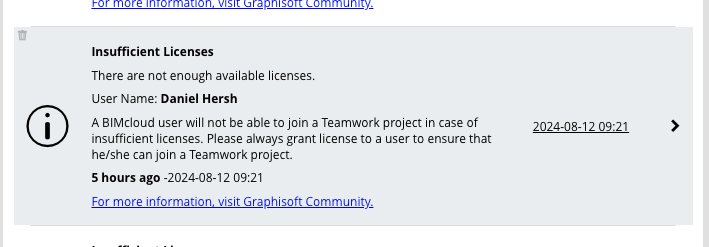

As an update, I did receive a message in the BIMcloud manager of Insufficient License- there are not enough available licenses. Out of 19 licenses, this is only the second I've assigned. I'm kind of stumped.

Sorry for the running monologue here but I unplugged my codemeter key and I was able to connect to the new BIMcloud. Does that make any sense to anyone or just a coincidence? Anyway, I'm connected and the license for that user shows it connected. Weird!
