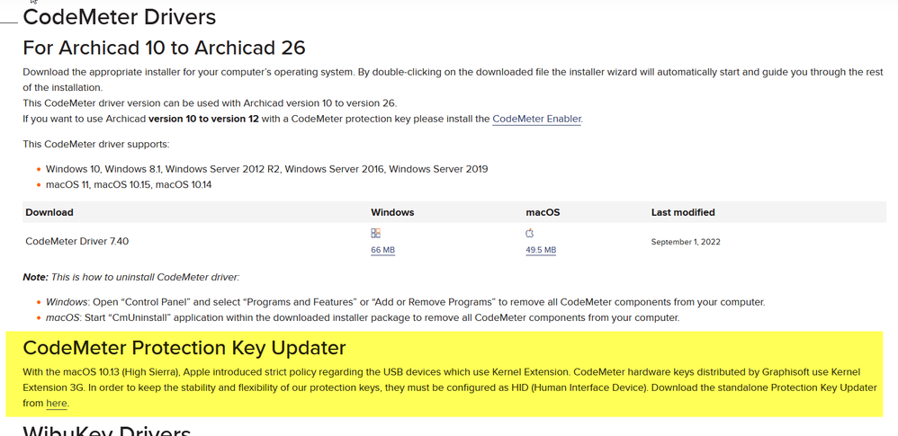

Does this help at all.
It seems there is something else you need to do with High Sieara.
https://graphisoft.com/downloads/protection_key
Hi Barry, that is for a Hardware Key correct? I have a software Key. I did try it but no joy. The codemeter driver installed from the original Install disc or download, would have a different codemeter driver version. The License Manager in 2019 was 20.0.0 v1 INT (4800). That worked then and of course the codemeter driver was also different back then.
So can't you uninstall the current codemeter driver?
And then re-install version 20.
That will add back the codemeter driver for that version I am pretty sure.

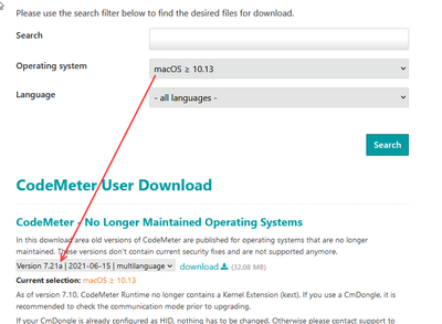

I am not sure if this is the Codemeter version you are after ...
https://www.wibu.com/support/user/user-software.html?tx_wibudownloads_downloadlist%5Baction%5D=index...
Sorry I know nothing about Macs and am not sure why 10.13 seems different to other versions.
Sorry, that link seems to take you to the 7.6 driver.
Just search for 10.13
6.8 is the driver that installs with the software, which the latest License Manager is putting up the error to. Tried to install the 7.4 and 7.6 drivers but they both freeze up and don't install. So my last option is to get the install .dmg file of an old License Manager. Support isn't interested and Graphisoft don't show legacy versions of the License Manager. Hence the title of the thread.
