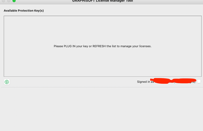

Hello
I currently run into an issue with license key! What a nightmare. Please could someone advise?
When I open archicad it says I don't have any license, even if I am logged in under a correct email. The license is showing turned on on the desktop on my profile. The tech support haven't got back to me and I am running our of time, I need to work on a project and not to deal with stupid & paid license :((((( I would say maybe there is issue with the Codemeter, I don't know I never ever heard about this issue and didn't think this can even happen
Oh! and the emergency license code... that does not work either! it says it does not exist while I clearly see it does.
Note: I am on MacBook, I did unistalled/installed everything again but did not help. I am licensed user (annual solo version)

While awaiting GS to respond, and if you have not already tried this, you could try going to your Mac launchpad and into the GS apps group (snip below), and opening the GS license manager tool from there.  It should show licenses active (second snip below) or the option to download from the GS server.

Update:
the Archicad support contacted me and found out that my license key got damaged (I guess through my computer clean up) and that’s why it showed active on computer but could not  find or put it back to the pool. They provided new key the same day thanks god. So I am very happy.
(I still think it would be cool to have a pool similar to what adobe has, easier to manage, put license in and out, and remove from computer if needed online if thing like this happen)…. I love archicad but it’s not nasa software to need this bullet proof license ( I mean adobe is bullet proof too but doesn’t have the red tape around)
