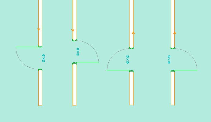

Select the edge of the fill to bring up the pet pallett and select the "subtract" tool.

Thanks.
I guess I did not look far enough.
