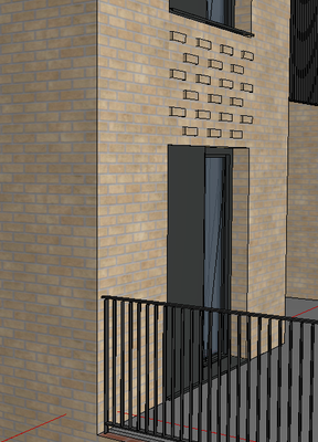

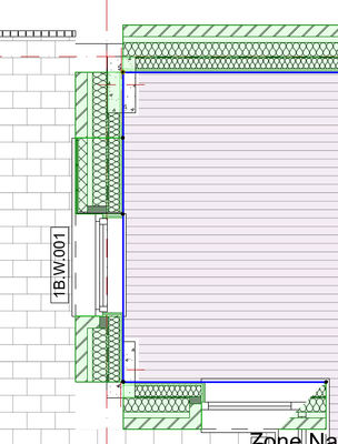

Help, I have a serious problem.
After my project shutdown by itself due to an ArchiCAD bug, when I opened it, ArchiCAD did repairs and now the walls are not showed joined, although in 3D is perfect.
I have attached some screenshots.
This is happening for every wall intersection, internal and externals.
Also, if I split a wall in two pieces, now it shows the line between them, previously it was a seamless joint.
Even if I make a new wall, composite or simple, is doing the same thing.
And that 'Clean wall and beam intersection' is on.
I don't know what to to.
Thanks

Check that all layers are visible, it seems that yiu have columns or some elements in a hidden layer.

Probably just turned off clean wall & beam intersections (not needed to reinstall)

Already tried that, it was one of the first things to do.
Nothing worked, it was probably a software bug.
