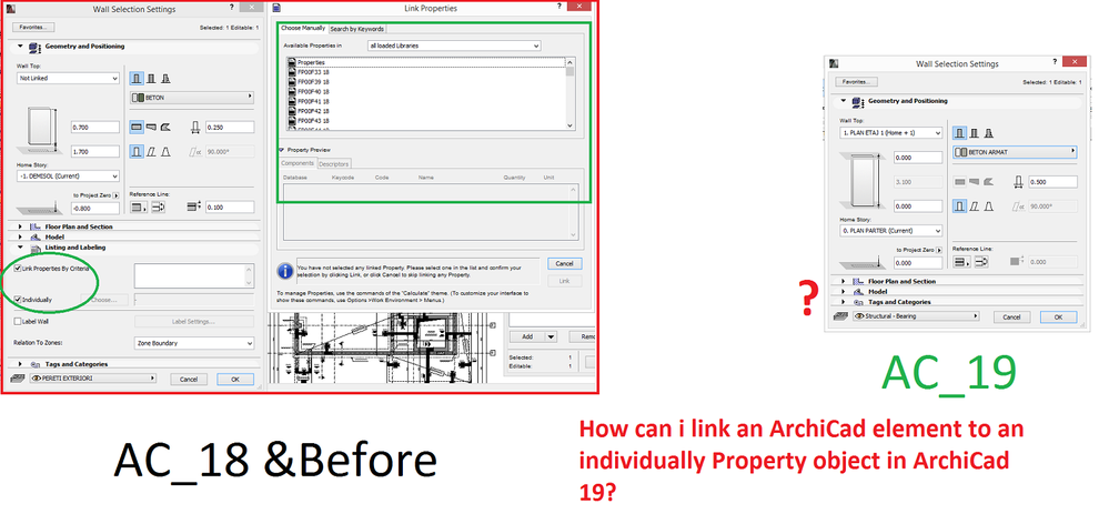

ArchiCad elements linked to a property object in ArchiCad 19
Hello everyone.
Please see attached file and if you know the answer, please help me.
Thank you

That panel is hidden by default in ARCHICAD 19 because the listing and property objects are rather legacy features.
You can go to the Work Environment Dialog and enable its visibility for any of the Tools in the Tool Settings Dialog Boxes page (make the Listing panel visible).
Cosminn
You're right Lazslo
Thank you.
