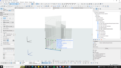

I created a graphic override for Quality Assurance which rules that any element with "Undefined" Structural Function will be painted in orange and the rest will be transparent . But whenever I go to 3d, everything is transparent even if there one element with undefined structural function. Please see pictures attached.
Please Help! Is this a bug? 'Cuz this has been the graphic override I used for QA since Archicad 25 and I don't know why it is no longer working in Archicad 26.

The rule list is executed from the bottom  - switch position on the two rules.
Sheena Marie Tamidle
I see it worked now. Thank you so much😀
