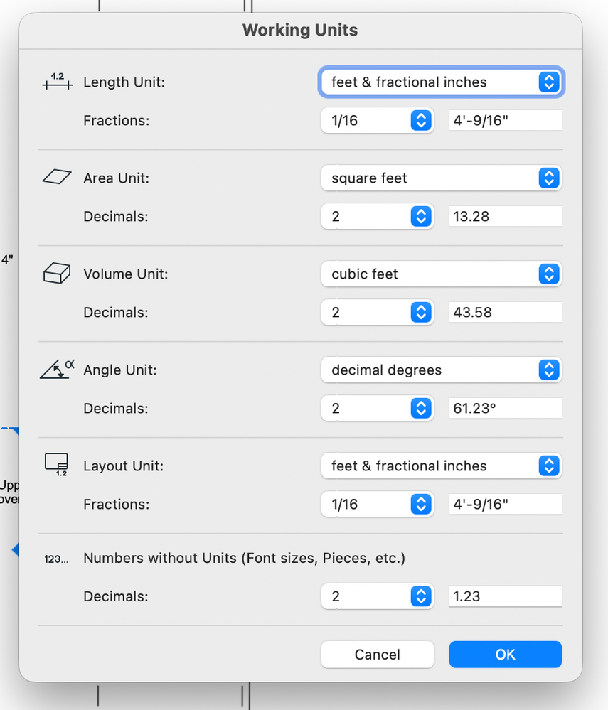

Archicad automatically inserts ' (feet) after first digit when entering distance
I’m having an issue when entering distances in Archicad. Previously I could move an element with Command + D and simply type the distance (for example 20' or 5"). Now Archicad automatically inserts a feet symbol ' immediately after the first digit, before I finish typing.
For example:
  • If I try to type 20, it automatically becomes 2'0.
  • If I want 10, it becomes 1'0.
  • If i want 5", it automatically becomes 5'.
Because of this I cannot type multi-digit values normally. I have to delete the ' symbol or use the Reference Distance (R) every time, which I did not have to do before.
Nothing in my Working Units (Feet & Inches, fractional) has changed, and I already checked Tracker and Coordinate Input settings, but the behavior persists.
Has anyone encountered this before or knows what setting could cause Archicad to automatically insert the feet symbol after the first digit during numeric input?

On further investigation, Archicad will add either ' or " depending on your working units.

Out of curiosity, I checked. Not only is this an issue with Archicad 29, it is also an issue with Archicad 26, Archicad 27, and Archicad 28 on macOS 26.4.
Jared Banks, AIA
Shoegnome Architects
Archicad Blog: www.shoegnome.com
Archicad Template: www.shoegnome.com/template/
Archicad Work Environment: www.shoegnome.com/work-environment/
Archicad Tutorial Videos: www.youtube.com/shoegnome
Which suggests it is a change in the Operating System that Graphisoft have not allowed for, because they didn't know about it.
The question now is, is there a setting in the OS that can fix this or has Graphisoft now got to issue a hotfix to compensate, which will only be for versions 28 & 29 now.

It's a bug that got introduced after updating to macos 26.4. hopefully it will be fixed asap. meanwhile, my fix is to type tab before inputing the number.
Archicad 28/29, macOS 26
Eduardo Rolon
Typing "R" or "Shift+R" also avoids the extra feet/comma.
