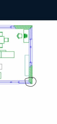

Hello, I want to create the composite wall you see in the photo, but I can't, I need to do it especially for that pointed output. Could you please help me?

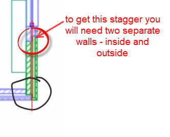

If you want different lengths inside and outside, you will need to split that into two separate walls.
Then extend the outer wall around the corner.
But better still you can create a complex profile column and place that instead of a wall.
The column can be exactly that shape you want and should automatically cut the wall away.

Is that attachments suppose to be a black box?
Are those sections of wall that are green due to the Renovation Filter?
Is your issue just the corner circled? How you are wanting to corner to meet?
Your wall is brick-air-membrane-air-cladding?
It is all one image - just a black area in the image as far as I can see.

Instead of complicating the wall - would you not modify the window to have framing that makes it Stagger. Note that "AIR" could be used to void a part of the wall.
