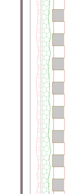

JeffH
Here is a snip from a complex profile for an exterior wall, where the courses alternate from type 1 to Type 2.
There is also a minor corbel.
Each fill is linked to their respective Building material, which reads their individual Surface.
That has been our method the last several years.
One exterior wall, spanning multiple stories.
