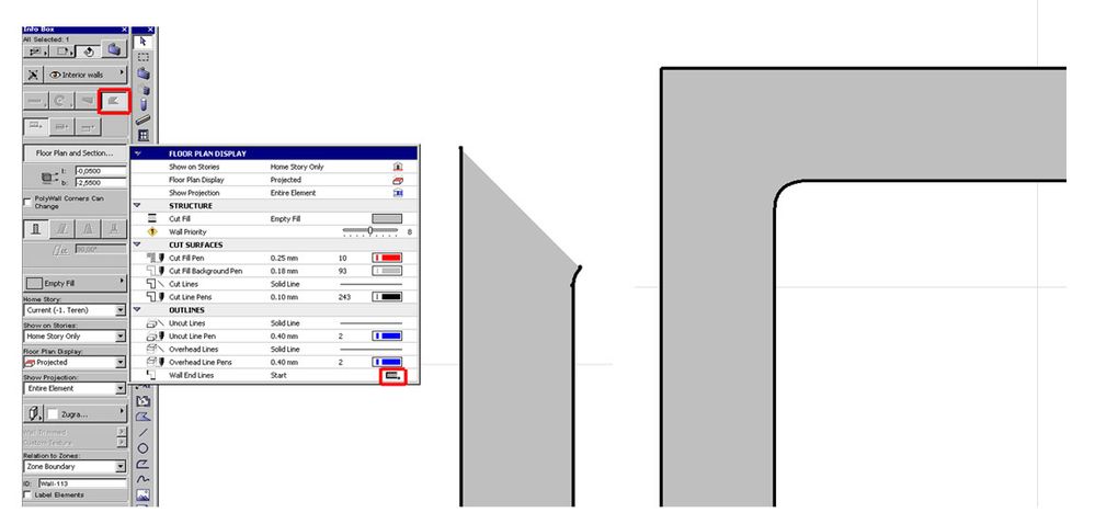

rune1980 wrote:You can try the "Fillet" command (using a small radius) for joining the two walls.
Hello, is it possible to bevel corner edges on walls, so that they are not 90 degrees sharp but a little bit round?

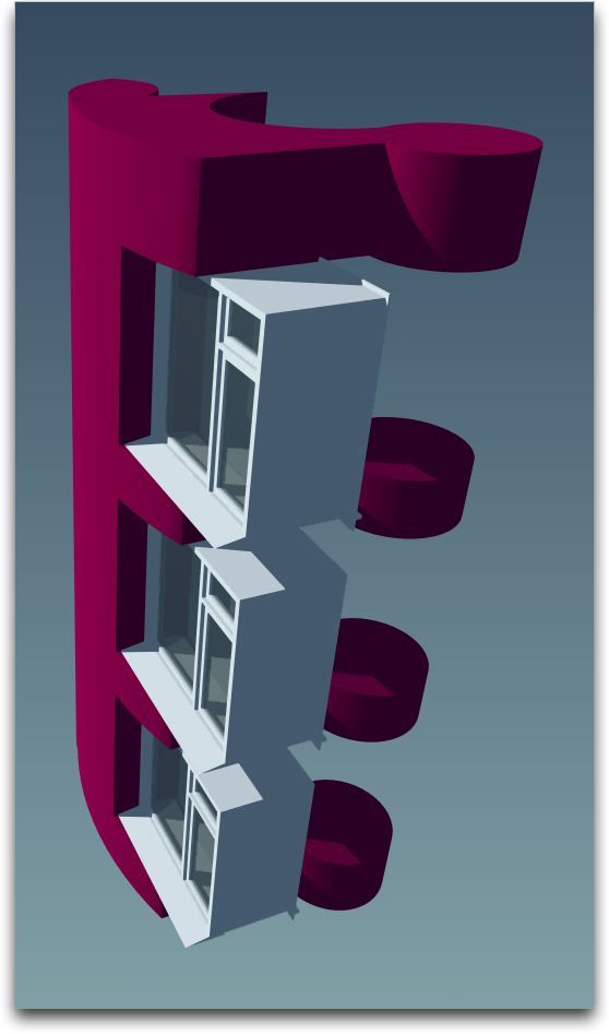

You can do anything with the polygon wall!!

rune1980 wrote:You can bevel the inner corner too (see attached image). Just play with your wall as if it was a slab. For getting a correct display in 2d, you can modify the way wall end lines are showing.
Dwight that does the opposite way that i want? I want it to bevel on the inner corner and not outer..
Cheers.

For verticals, a slab, for horizontals, a custom profile wall and for general elements, an object - the L beams 11.
