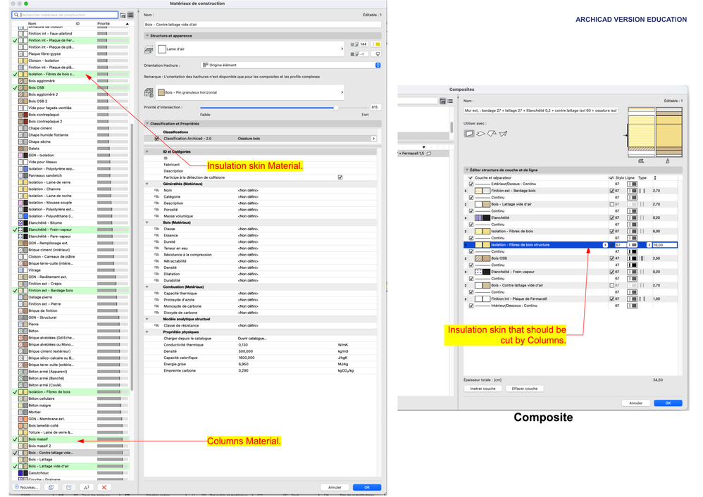

Hi there is a bug intersecting composite walls and columns (see attach)

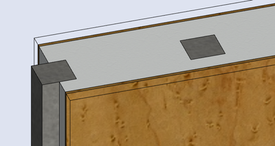

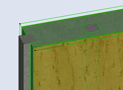

Thanks for the file.
I have a potential solution, but I am not sure of the exact cause - there seems to be no logic.
In your composite, these two skins have a building material strength a little stronger than the column.
When I set them so they are slightly weaker than the column, then the wall is trimmed as you would expect.
There is another skin that is stronger as well, but that does not have to be changed.
I am not sure but it might be because it is on the other side of the 'core' skin.
But even if I set them all as 'core', I only have to change the two highlighted in yellow.
So make those 2 building materials are weaker or make the column building material stronger.

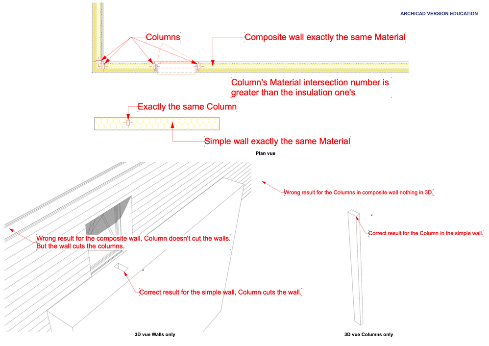

That's not the problem, I'll try to explain it better (see attach).
Columns Material is "Massiv Wood", the composite skin where they sit is an insulation material.
The wood material as an higher strength than the insulation.
When the columns are placed in a simple wall with the insulation material they cut it witch is the right result, but when placed in the composite in the insulation skin the columns are cut by the wall, witch is false.

Double check carefully the column and wall building materials.
In the 3D line image I can clearly see the wall is cutting the columns.
This should not be the case if the column building material is stringer.
In the list on building materials, you show the one used for the column, but are you sure that is the one actually used?
The images are not high enough resolution to read clearly and you don't show the actual settings for the column.
Try setting the column to the highest strength building material that you have and see if that has any affect.
Hi Barry,
I check the building materials and they are as described.
I try other materials for the columns with a higher strength than the insulation and some are working correctly like "Vide d'air", "Acier" as they cut the composite wall, but others like "Bois massif", "Gravier", "Bois massif 2" aren't.
I join a plan file for you to see.

Ok !, in fact just giving the Column's material a higher strength than the "Bois - Lattage vide d'air" is enough to solve the problem.
But for me it's really a bug as the only skin involved in intersecting with columns is the insulation one and the other skins shouldn't have any influence.
