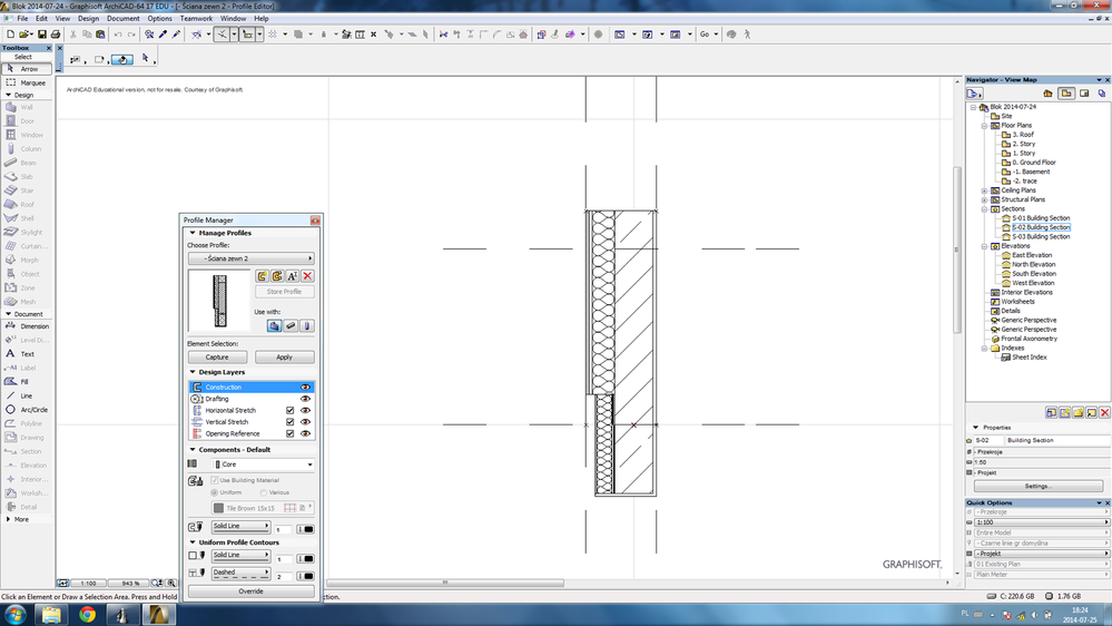

sometimes I have a certain problem with connections of building materials. Here for example a wall profile connects to two slabs. Concrete material is the strongest so I expect the concrete in slab to connect to the concrete in wall. However, the insulation breaks the construction.
Any ideas what I have done wrong?

How does the Wall Profile look like? Can you post a screenshot of only the Wall Profile?
Thanks for the reply. Here's the profile.
Can you put this connection into a separate project file and put it on Dropbox or something?
Just from the Wall Profile I cannot see what could be wrong.
The problem doesn't show after copying. Or maybe there are some other elements interfering which I should copy too.
I noticed that it disappeared after I changed the thickness of the slab. It happened in one of my other projects before and after changing the configuration of layers it disappeared. It can't be cheated by leaving the layers visibly unchanged though.
