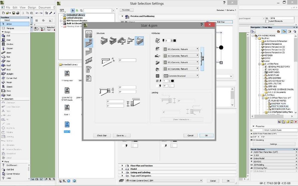

In the stairmaker tool, for a solid concrete stair I obviously choose the last "structure type", which then grays out the option to add a nosing dimension to the stair. Code requires a nosing with a tread depth of less than 11", so how does one add a nosing to a concrete stair?

Use a profile to get the canted nosing of a typical concrete stair.
The solid stair type you choose just doesn't have a nosing option.
