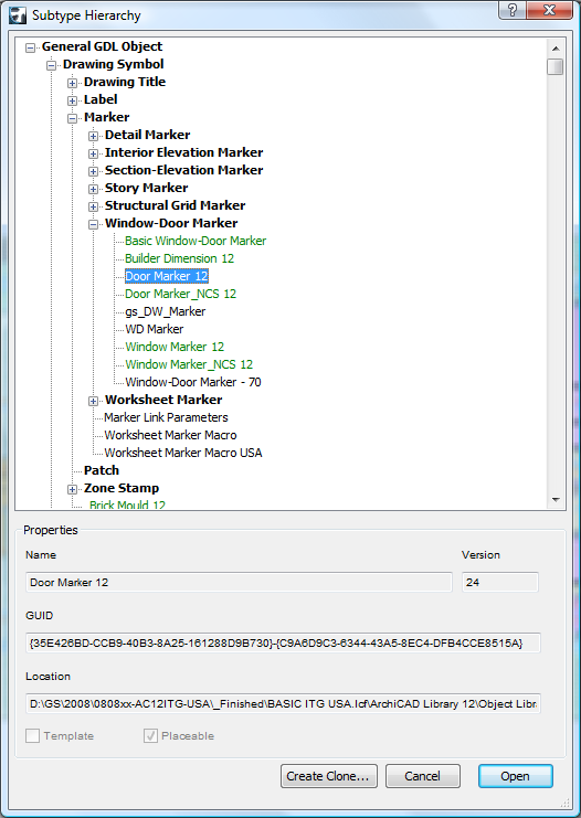

The only workaround I can think of is that you open the Marker for editing (use the Open by Subtype command - its menu command is not part of the default Work Environment, but it can be found on the Edit GDL Library Parts toolbar. Then set the default parameters to your liking and save it under a new name.
Do this as many times as you need different Door Markers.
Then you can do what Matthew wrote: select a different Marker which will come in with its default settings, which are the ones you set to your liking.

You can always open any GSM file for editing using the Open by Subtype command.
Another thing is that a Door/Window Marker will not appear in any object setting dialog but it will appear in the list of selectable markers in the Dimension Marker panel of the Door/Window Settings Dialog.
vfrontiers
I just tried to create a new marker for quick placement as described here. I, too, was unable to see it in the list of markers.
Turns out the object defaults with PLACEABLE unchecked... Simply check it and it will appear!
