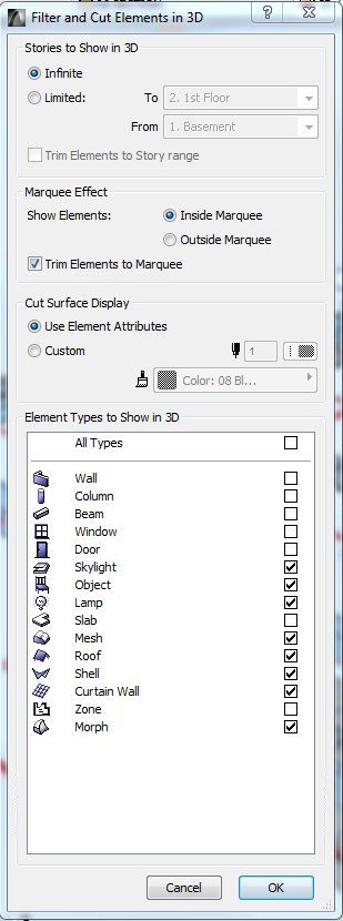

Doesn't Arhicad have the option to filter stairs in 3D like others elements?
Or, I'm missing something here?

Yes, it seems the Stair Tool does not have a separate checkbox to control it.
It is controlled by the checkbox of the Object Tools since a Stair is a type of GDL Object.

Ahh, Ok,
Thanks Laszlonagy. I knew I hid Stair in some occasion before.
Thanks! Anyway would be handy sometimes to have a separate checkbox for stairs, I'll need to hide them by layer in this case.
