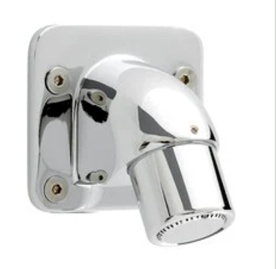

if it's something more like this screen shot, it'd be about 30 minutes building it out from scratch (I'd use morphs and shells and save it as an object... if there are common parts and pieces you need, I translate cut sheets to objects all the time; would be happy to help or even give a how to session on basic object development.
