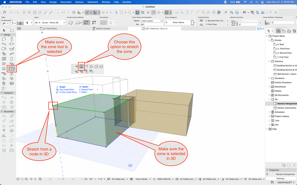

We have this issue as well in AC25 USA.  Filed a support ticket and got this back.
Try stretching the zone with the Zone Tool Selected. Also make sure the zone is not being trimmed by something.
