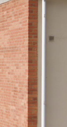

I'm digitalizing old drawings to make an IFC model of a building. It has a brick facade, meeting a plaster facade.
How would you model this kind of meeting?
It's a plastered concrete wall with a brick layer on the outside.
Thank you!
/Kaj

Could you have two wall composites, one with brick and plaster (red), one with just plaster (green)? Have those join as normal, and then have an L-shaped column via a complex profile that is only brick (blue)? That's one way I can think after a quick glance, but there may be others.

Yeah, that worked great, thank you!
/Kaj
