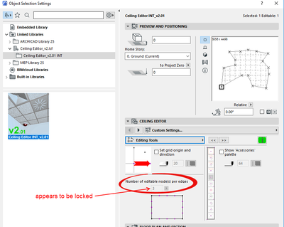

I ran out of points due to a fairly small room with shape and walls.
Can I create more points?

If that is the object I am thinking of, it is not a standard part of Archicad.
It can be downloaded from BIMComponents but appears to be quite old and written for version 16.
When I download and add via the Library Manager in 25, it does not appear to work properly.
Many of the parameters appear to be locked.
If I load it in Archicad 20 it all seems OK except the 'Accessories" palette does not work.
But I did see a post ... https://community.graphisoft.com/t5/Design-forum/ArchiCAD-21-manubim-com-Ceiling-Editor-v2-01/m-p/22...
It is a few years old and mentions it does not work properly in newer versions.
I don't have time to follow it all up, but I extracted the LCF file (that downloads from BIMComponents), then opened the library part and simply saved it again.
Now make sure you are loading that extracted library and not the original LCF file in your Library Manager.
Now when I place a new object I can edit the number of editable nodes up to 6 per side.
Existing placed objects still do not work.
You have to 'reset with default settings' or simply delete and replace the object.
There still seems to be errors with the 'Accessories" palette.
I think that is just because it was written for an older version.

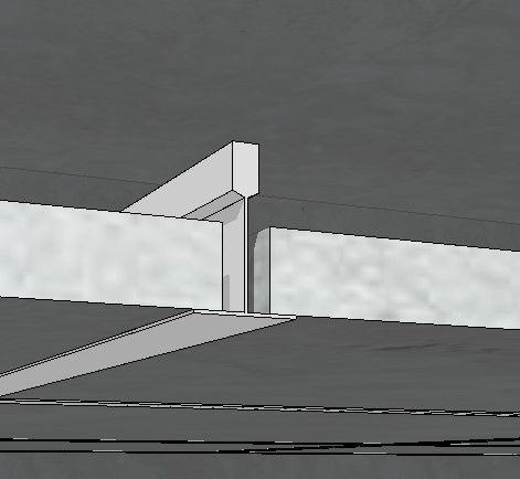

Yep. I just started doing this and was surprised by how easy it was. Takes a little fiddling to get it exactly as you want. Once done, so easy to switch from 2x2 grid to 2x4 grid, etc. I just have to model up some lights, diffusers, etc. to use as "distinct" panels.
