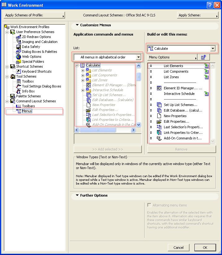

I don't have a List Schemes / database in my calculate menu.
Is there a way to get this there?

You are probably using the Standard 9 Command Layout Scheme.
If you have not had a training on changing your work environment, or have not spent an hour or two customizing it, now is a good time to learn about it in the manual. (A customized work environment must be saved if you ever want to see/use it again in the future after either a new and reset or trying a different work environment.)
To quickly see these commands, go into Options | Work Environment, then Command Layout Schemes and then select US Standard Command Layout Scheme 9, click Apply and then OK.
Karl

jcude wrote:
I don't have a List Schemes / database in my calculate menu. Is there a way to get this there?
Just to reduce time on discovering in TG
