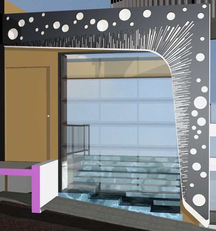

is there anyone that can tell me why 2 complex profiles, made from the same fill, once placed into the model, don't match anymore?

Though my current main issue is about 2 complex profiles that don't match. They have been created from the same fill: one is solid, the other has been carved.
If you look at the attached image you know what I mean.
It looks like as if it shrank. ..how can I fix that?!

Hello again,
I forgot to mention that the complex profile was associated to a wall and, after a more detailed check, I noticed that it stretched only along the Y dimension, the X was perfect.
I tried to associate the complex profiles to a beam and now they match perfectly. I solved my problem but still don't know why it was doing that as wall!?

Thank you David.
I've attached the screen shots of the Profiles as requested.
The first Profile is the original I made with the shape we wanted.
The second has been a duplicate of the first which has been 'carved' here and there.
Hope it will help
