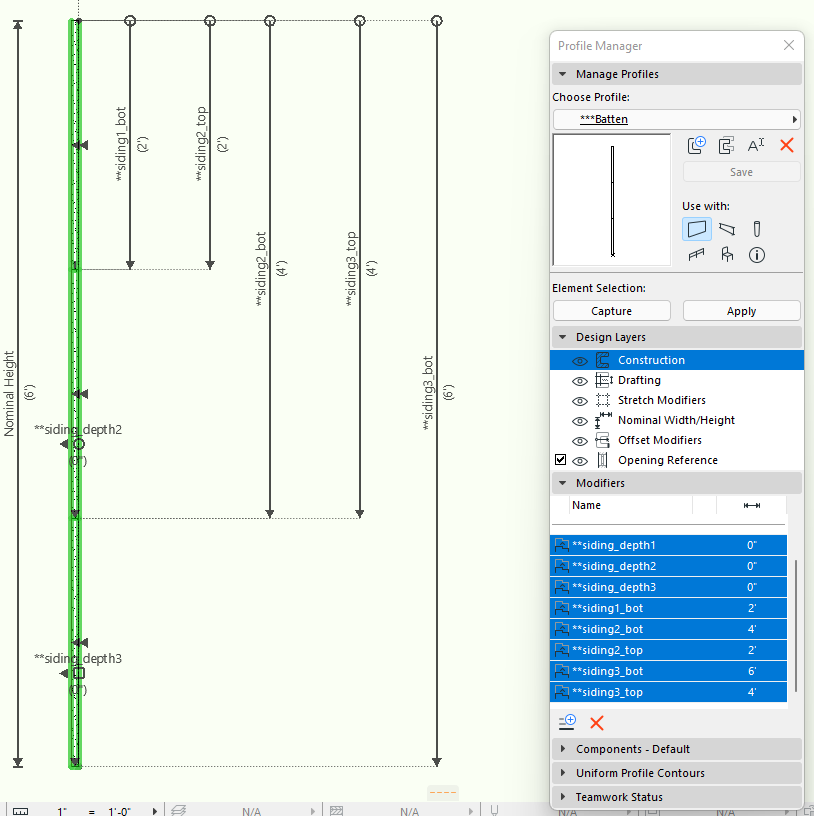

Jere
Here's how I set them up:

Have you seen this video from Shoegnome using Create Openings from Selections? https://www.youtube.com/watch?v=68i6A2ansl4&t=3s
It works great cuttings complex profile walls at all the windows / doors in seconds.  If you moved the windows or doors, you can delete the openings and do it again.  I just did it for the first time.  I noticed that it didn't work the first time around.  After some some research and found that you need to have the casing turned on and make sure it extends past your siding thickness, then you can turn it off once you complete the task.
