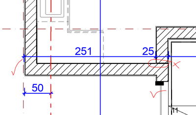

Hi everyone,
I hope someone can help me. I have a wall with two corners. On one side is simple corner and on the other side is 3 walls intersecting. All walls are the same composite wall, The reference line on the outside face, same junction order, same overall parameters. I am posting pictures with the problems.
When I use the intersection botton this is what happens:
Any Ideas why this could happen?

Hello @coty
It seem to be because of another wall below or above this one. Did you check these walls through a 3D view or a section ?

Select the wall & check BM priorities if the composite edge is higher than the block skin make it lower to enable correct intersecting.

Hi @Christophe Fortineau
Yes I checked. I actually extended the height of the wall under (that is not the best solution) but it worked
@Mahmoud Qenawi The priority of the block is higher so I dont think this was the problem. But thanks.
Sometimes that happens cuz different heights for walls or different home storeys.

@coty
You seem to be using a composite wall which includes various materials. You need to consider all the materials in this composite wall. On the contrary, I think that the interaction between these two walls is the cause of your technical concerns and that the various materials of your composite walls deserve greater attention. Can you share a small file that only includes your walls ?

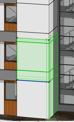

So now this is what I did:
I extended the wall from under
And this is what happened: What I wanted to fix I fixed it but came out with other problem
Do you have to extend it to double height?
In this case I would extend the lower wall only to cover the RC slab and better create another wall belongs to the story above to avoid intersection problems.
