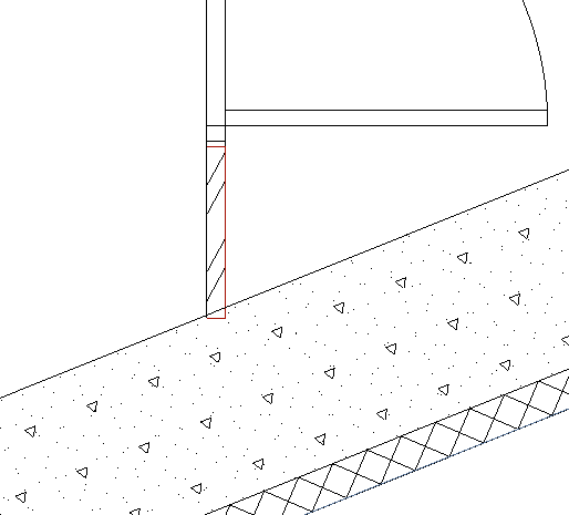

How can you connect theese two walls? @GRAPHISOFT

Hmooslechner
connect the wall-guidlines, have a look at the options - building_material-intersection priority number.
Lingwisyer
Guru
The Reference Lines need to intersect.
If they are intersecting but NOT joining, check your Layer Groups. Things will only join to things with the same Layer Group as their own. Note that Layer Groups are Layer Combination specific.
If they are intersecting and ARE joining, but incorrectly, check your Building Material Intersection Priority.
