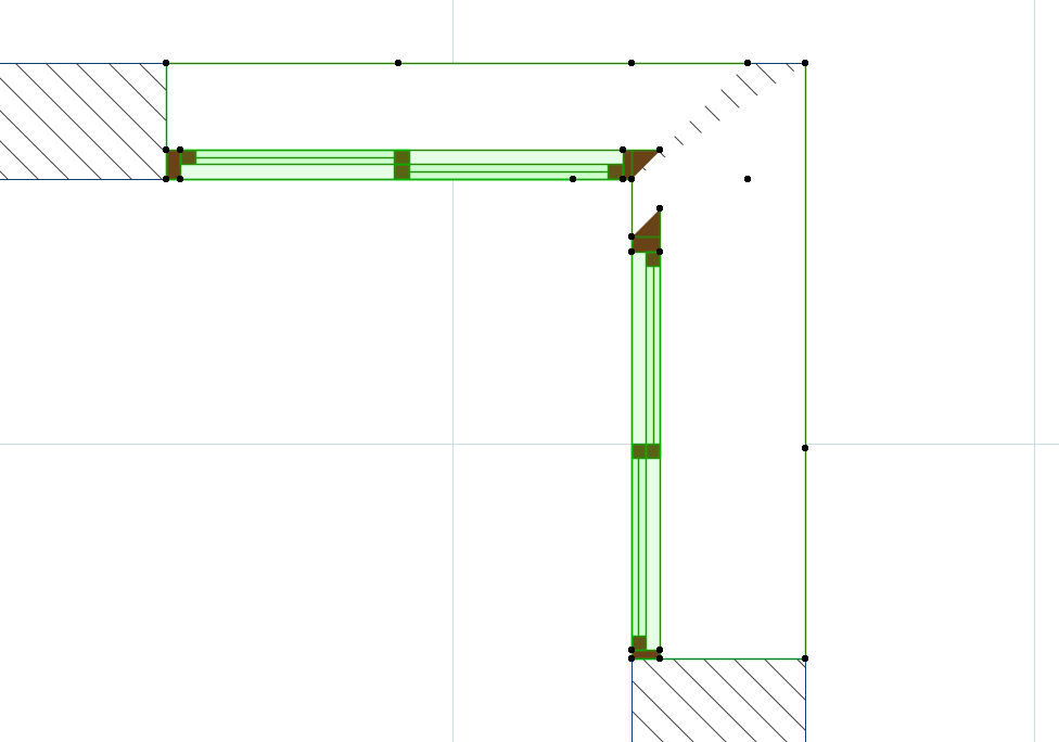

Hello,
i think it's a strange behaviour from Archicad as i remember i did this before correctly,
Placing corner windows on 2 diffentent walls causes problems in the corner frame, it won't connect even when i check " different wall thickness " and i add the thickness
Any soltion please ?

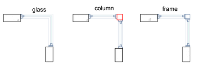

try the other Corner ?
Also, both Window and Walls can be set to Projected instead of Symbolic - ?

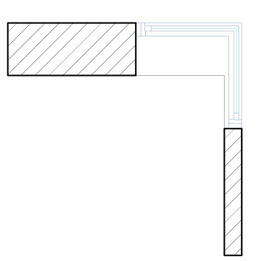

Thanks steve for the reply,
It works for walls with the same thickness, but not with different wall thicknesses, Archicad 23

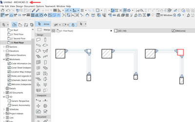

Like this -  but does not work with 23.  I got it.

It works for me in 23 as well.
It could be that his happens with a certain window type.
Something is not quite right. I have been able to generate the anomies a couple of times but I didn't notice it time to find what it was using Ctrl-z.   What window are you using ?
I was able to get it to look correct using some the Bring To Front tool and changed settings to Projected rather than Symbol.  I think it has more to do with getting things to rebuild than the settings changes ?

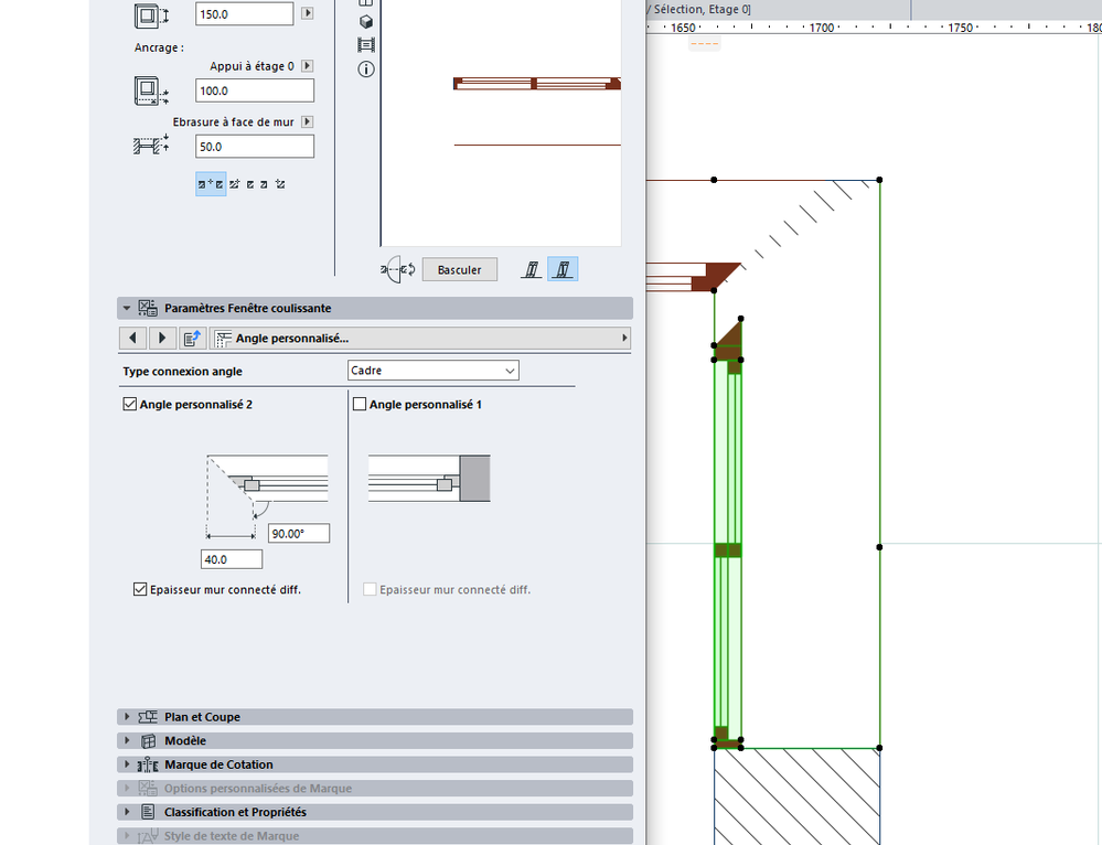

I glt it,
It works only when reveal is set to 0, then, i should place my windows on the inner face,
