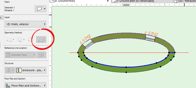

I am developing a new complex and one of the buildings is elliptical in shape. It is indicated in the picture with a yellow ellipse. While drawing and sizing the ellipse was easy, what I can't figure out is how to make/create an elliptical wall. I can approximate an elliptical shaped wall by breaking down the wall into segments but problem with that placing windows and openings as they cross segment lines which then requires 2 of an item (one in each wall on either side of the segment line) which becomes problematic. What I need is a way to make is a continuous wall around around the ellipse. I can even live with a split wall like those created when making a full circle wall. As this is  apartment there will be lots of windows and balconies. In my MCAD software I would pick the ellipse as a sweep path for the wall cross section to be moved to create the elliptical shape. I did a lot of searching but I couldn't find such a function in AC.Is there anyone who can tell me how to make an elliptical wall?

Have you tried magic wanding the ellipse with the wall tool active?

There are no ellliptical Archicad walls. Magicwanding will approximate the ellipse by splitting it into segments, defined by points along the ellipse, with their positions and the circular arc wall curvatures following magic wand settings. Now those arcs with different radii meeting at those ellipse points defined by the magic wand settings *will not share the same tangent where they meet*, there will be a vertex at the point (for that not to happen the centers of the smaller-radius arcs in the sketch should be positioned along the edge of the larger-radius segment to the side; like juxtaposing slices of large and small pizzas) –which is almost OK for preliminary and perhaps schematic, but becomes a pain once you need to get moderately serious about geometry, need to define radii and centerpoints for those arcs; also at least some of those corners will show as lines in 3D. So if you care about all that your options are:
- laying out your approximation to the ellipse using lines and circular arcs, old school, juxtaposing those pizza slices along their edges
- [I last looked into this a few years ago, but I am fairly sure it is memory talking and not imagination:] with Grasshopper you can lay out that approximation with cotangent arcs; so if that ellipse will be moving during the design process or you want to try variations, and the project justifies the trouble, Grasshopper can help.

Karl suggested trying the magic wand approach which I did. The result was a wall created in segments which doesn't solve my window placement issues. I guess I will have to add another wish for a continuous ellipse wall like my wish for a continuous circle wall. Actually it would be nice if AC could create a continuous wall defined by a spline (with multiple radii curves) for more organic designs. It's easy to do in any MCAD software so there shouldn't be any issues in AC having that capability.

Wile: my suggestion was *not* to magicwand. Laying out the geometry yourself or doing it through Grasshopper is the solution to your current problem in the world as it is.
[Edit: Barry’s polygon wall is a great suggestion too, if you don't need wall layers, a typical wall assembly.]
If your window layouts change story to story,
- the ellipse layout including wall splits between different-radii arcs needs to be the same across all stories, because otherwise (even regardless of geometry for construction purposes etc.) the walls won't stack, the wall surface will not be continuous and it will show in 3D;
- so you could go either single-story or multistory Archicad walls (which I most absolutely hate; but one still sometimes needs; with sloped walls, or in this case if you want to modify the ellipse layout or wall splits across all stories, with windows placed differently on each story so that the envelope can't be modules),
- and in either case, the world being what it is, when you need to place windows across two different wall segments, the window will belong to one wall and you will need to cut the other one with a dummy untagged non-schedulable empty window or opening or such. Hopefully flat-frame windows, because for a varying-radii curved window you would need to create a custom object, to be placed on two dummy openings/windows.
