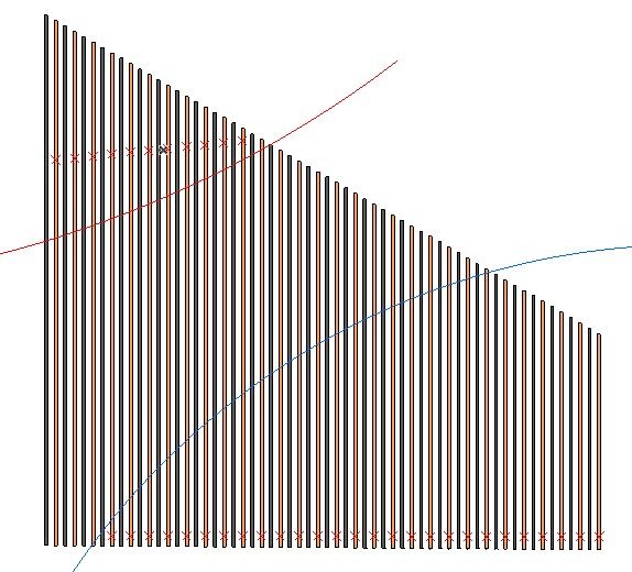

Second Query.
I want to trim only the orange members so the tops intersect the red curve, and the bottoms intersect the blue curve.
Trimming and extend options aren't available. I have tried to manually stretch each one, but you only appear to be able move, not alter length.

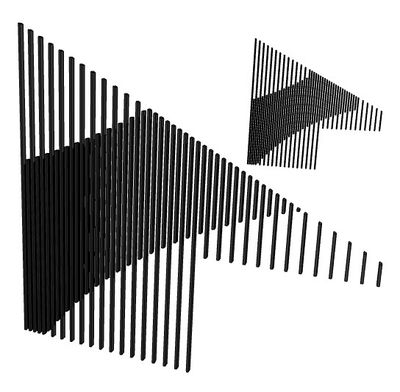

The hope is to get something that looks like this (example using columns).

You can then either make adjustments to the boundary there, or you draw something new. See also https://helpcenter.graphisoft.com/user-guide/128176/
The second thing only works with two different CWs. Or you would go into there and adjust every single frame. (not a real option tho)
