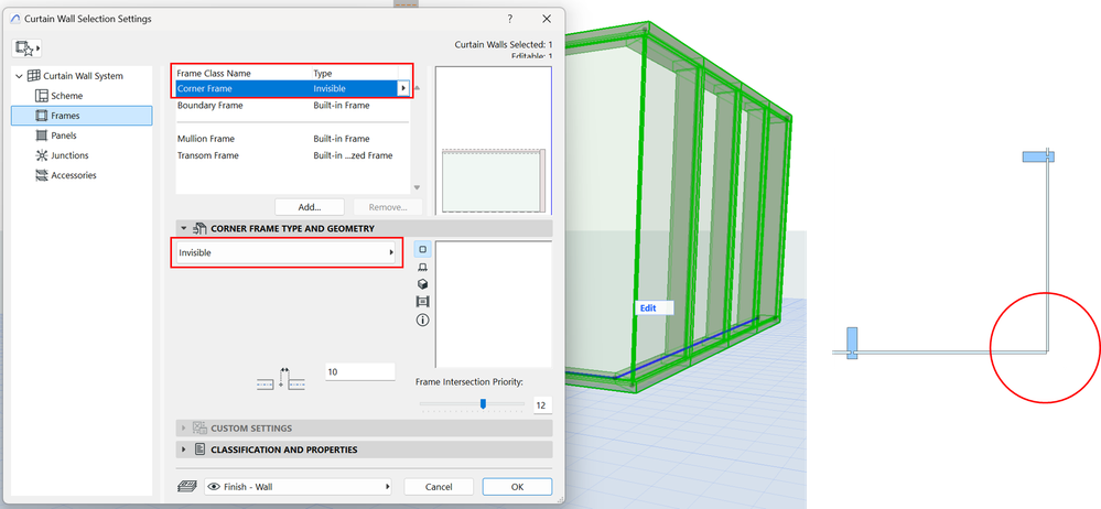

Hi @StefanV_BCP
You could edit the corner frame and make it invisible.
If this is not what you need, please send a sample picture.
