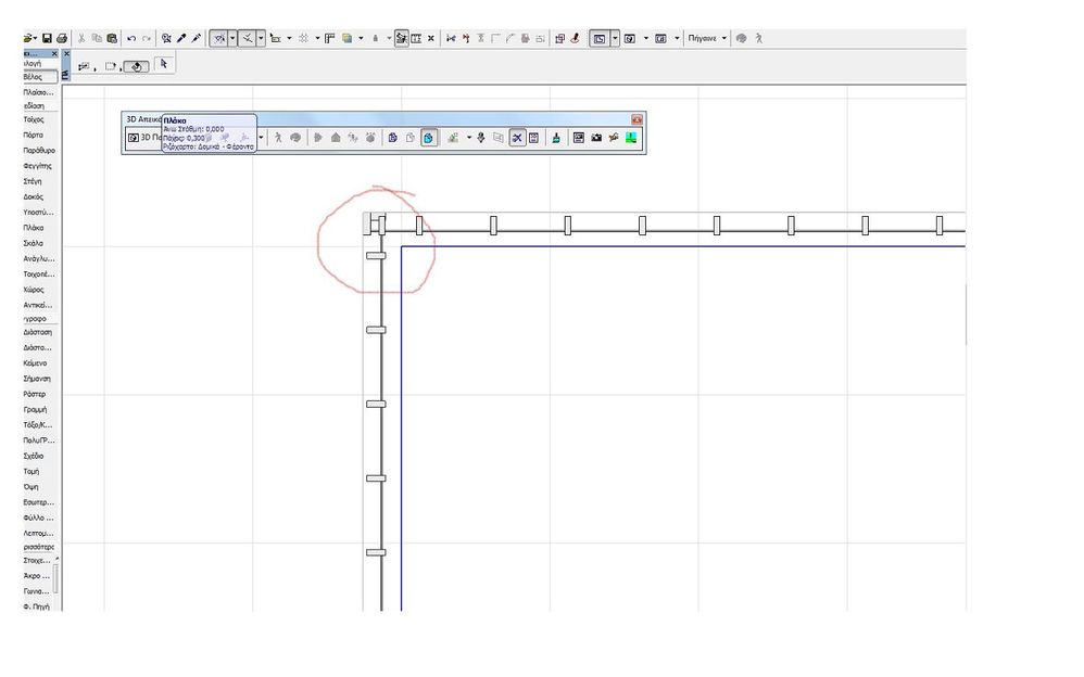

When I used the create common frame it maintains the old frames along with a new vertical (why not angled at 45 degrees) frame.
There is a command: Design\Modify Curtain Wall\Create Common Frame.
You need to select the two Curtain Walls and then use this command.
Check the help file for more instructions.
But there is something wrong here: it does not create it for me.
I do the simplest thing and it does not create it.
A bug?
The other option is to use the polyline creation method when you place the two Curtain Wall segments so the corner will automatically be correctly created.
@laszlonagy
That is exactly what I was doing Selecting both walls and then pressing Create common frame. You are right, the best solution is to use the polyline curtain wall. But that is not the point. When one thinks that in AC 12 the Create Common Frame worked perfectly, why not in AC13?
I figured out what the problem was:
The End points of the Glass Plane must meet, not the End points of the Reference Planes. See The attached image.
What confused me is that in AC12 the end points of the Reference Plane did not have selection dots. In AC13 there are, so each Curtain Wall segment has two sets of selection hotspots.
Also: when the Common Frame is created, the firstly selected Curtain Wall's boundary frame will become the Common Frame, and the other Curtain Wall's boundary frame will become invisible.
