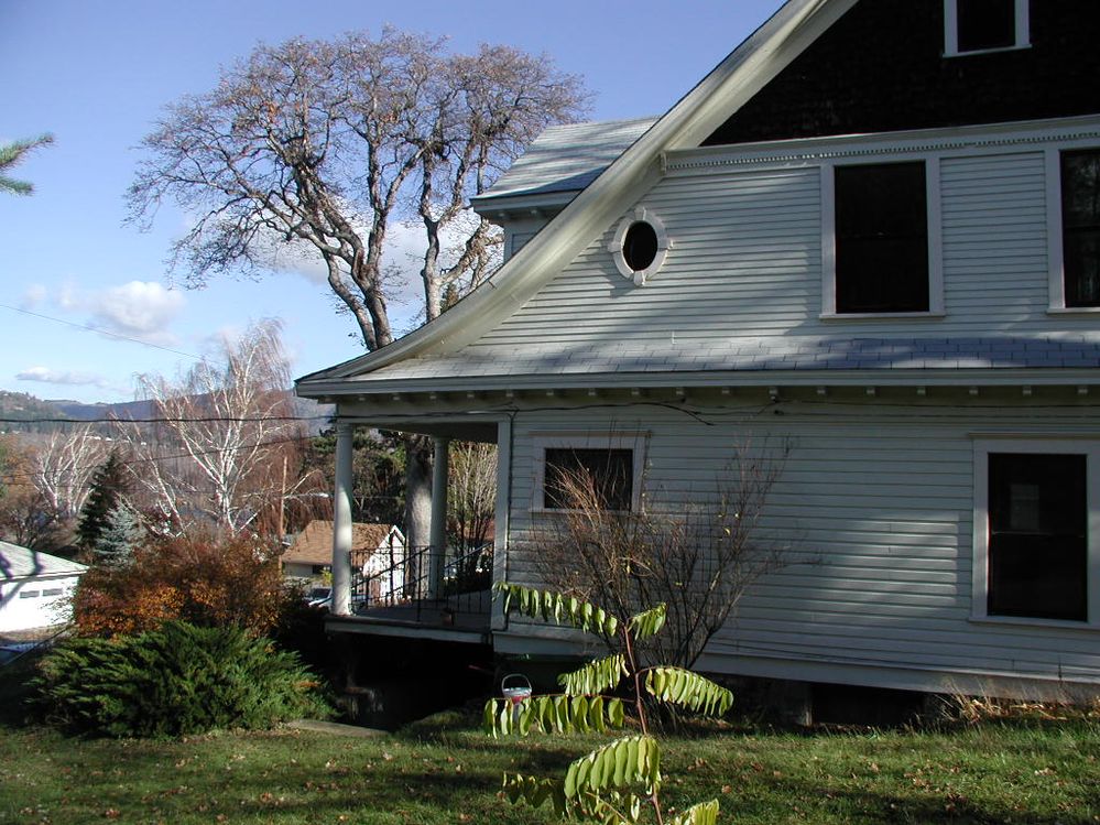

I am looking for suggestions on how to achieve the curved roof and fascia detail as shown in the attached pic. Oh, uh, without gdl if possible. I assume I would model the roof with the curved roof tool but the fascia method escapes me.

David,
When you say "fascia" are you referring to the lower clapboard
part of the gable end ?
If so, is the clapboard part curved or "kicked out at the bottom
or is it vertical and just the shingled part curved out ?
It's a little hard to tell from the photo.
If I have missed your meaning please clarify.
Thank you,
Peter Devlin
David wrote:
... I assume I would model the roof with the curved roof tool but the fascia method escapes me.
Yes, do the curved roof portion with the roof tool...unfortunately, I need to use the "GDL" word regarding the fascia. Why don't you try some graphical GDL? After you model the roof do a quick 3d view of the elevation...copy the line work of the area where the curving swoop is and use the line work as a template...Paste the linework on plan and model the trim geometry with slabs and/or walls ... save it out as a "static" object to apply to the model.

Personally I wouldn't get so complicated as to create GDL to solve the problem.
Rather, I would call up the elevation, create a fill to match the gable fascia, copy it to floor plan infill with a slab with the desired thickness, select it and view it in 3d, set the parameter to side view in navigator and rear view at 90 deg. , then go to GDL Objects in file menu, save 3d Object as.... and save it as a library part.
This may be an over-simplified way of achieving a result but it is fast, familiar and doens't need a lot of investment in syntax and object language to pull off...
Just my way of keeping it simple....

Since we are apparently talking about the rake trim (I wasn't sure)
would not TrussMaker do the job ?
Peter Devlin
I would use profiler to model the rake fascia. Look at the model in elevation view and draw with lines/arcs the shape of the roof. Paste those lines into the plan window. Draw the profile (section cut) of the rake fascia. Use profiler to create the trim. As you are aware this will be "lying flat" versus how you need it in your model. You need to now do as others have suggested and look at it in the 3d window as you would see it in plan view (elevation view looking from the top) and save it as a library part (file menu - GDL objects - save 3d view as). You will need to use solid element operations to trim it to the lower roof.
