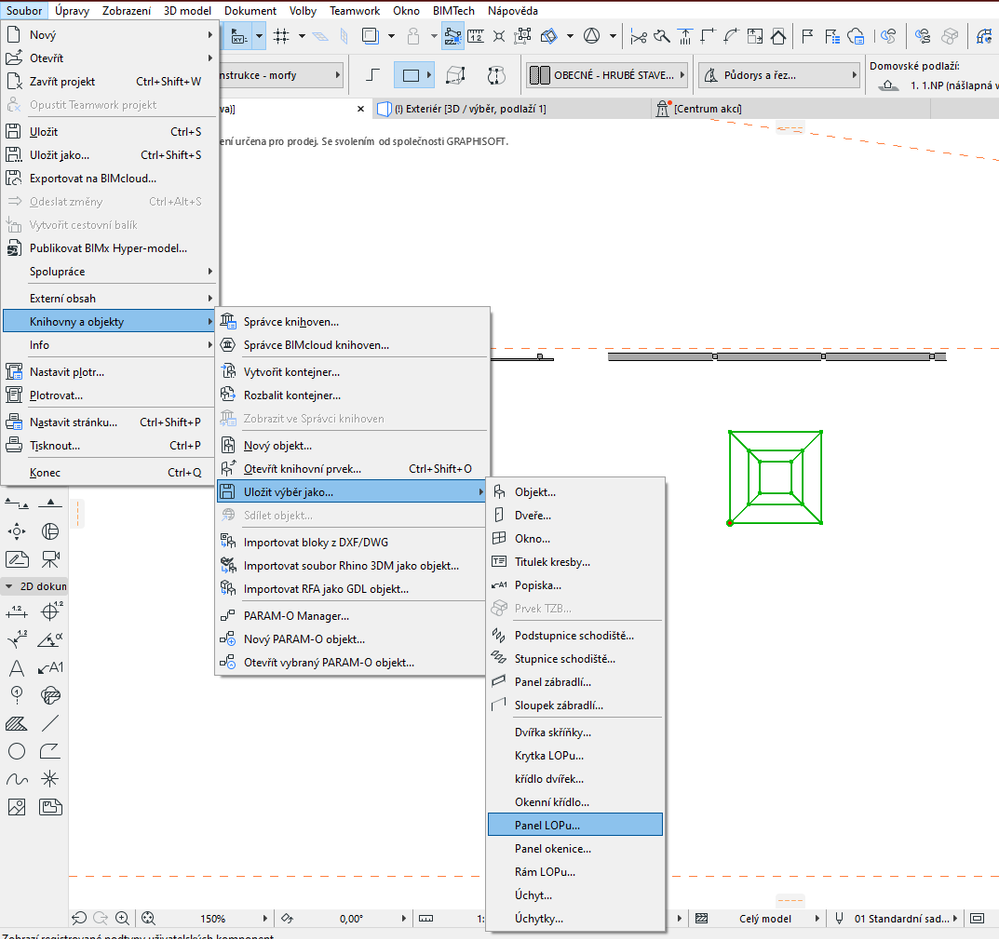

I'm having a hard time loading a custom made curtain wall panel into a curtain wall. I export the panel made by morph properly according to the steps in tutorials and youtube (select the created panel -> export as curtain wall panel). Then in the curtain wall settings I select the custom panel I made, but it loades as flat, plain surface! I really don't know where do I make a mistake...

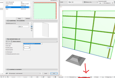

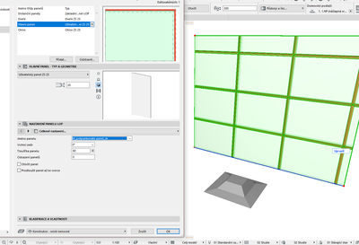

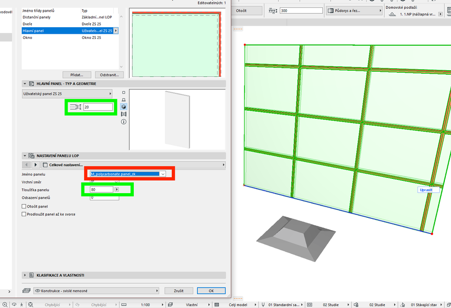

This has nothing to do with the student version. I did a test where it works fine. Check that you have chosen the right panel (in red) and that the thickness is set correctly (mm/cm/m?). I did a test where it works fine.
