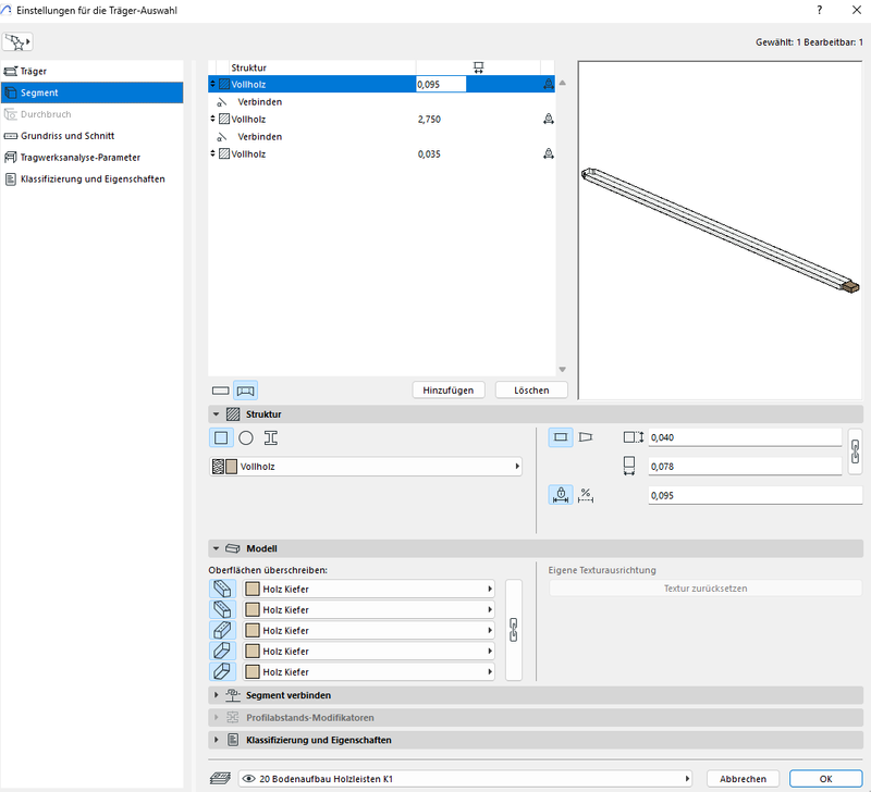

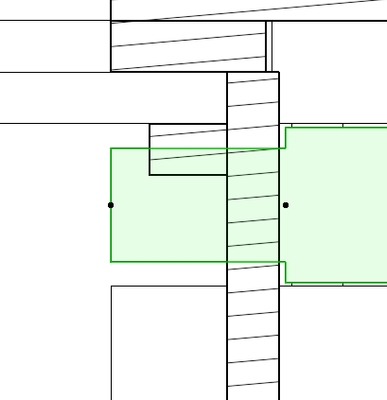

I would like to cut the end of a beam in a specific way. In the screenshot you can see my hand drawn lines.
I want to cut the upper left corner of the beam.
Is that possible?

CosminF
For me its not very clear what are you trying to achieve, but look up beam segments, you can achieve your desired results with that I reckon.
More info on that:
https://community.graphisoft.com/t5/Modeling/Beam-Segments-Tips-and-Tricks/ta-p/303944
hope this helps.
This is almost what I want. Thank you.
But is there a way to move the segment? Tried everything.
I would want it to be aligned at the bottom. But its always centered
You can edit the anchor point of the last segment to be offset (the symbol is 9 dots in a square pattern). In this way your beam will have the asymmetrical shape you are after.
These are the only options I have at the two anchor points.
CosminF
You need to go into the settings on the beam (ctrl+T) , choose beam segment in the left menu and edit there.
 But there is also nothing to edit. No offset atleast

You can only set the reference for the beam or column uniformly. There does not seem to be a way to do it by segment. One workaround that can work in limited circumstances is that you use a Complex Profile that contains your offset for your segment.
