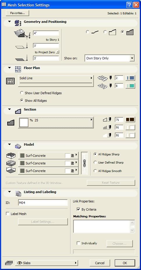

here are the current settings of the sill mesh:
ArchiCAD 26; Windows 11; Intel i7-10700KF; 64GB RAM, GeForce GTX 3060
