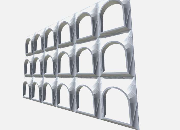

Sometimes the good old AutoCAd is best! Yes, we have to admit it!
It took about 30 minutes to model this including the preliminary plan and side drawings!
It is such tasks that make me still keep AutoCAD on my computer!
Finally back in AC!
I really hate the way AC imports 3D geometry from other applications! It took me 1,5 hours to just transform it the way it looks now!
Of course, smoothness is gone!

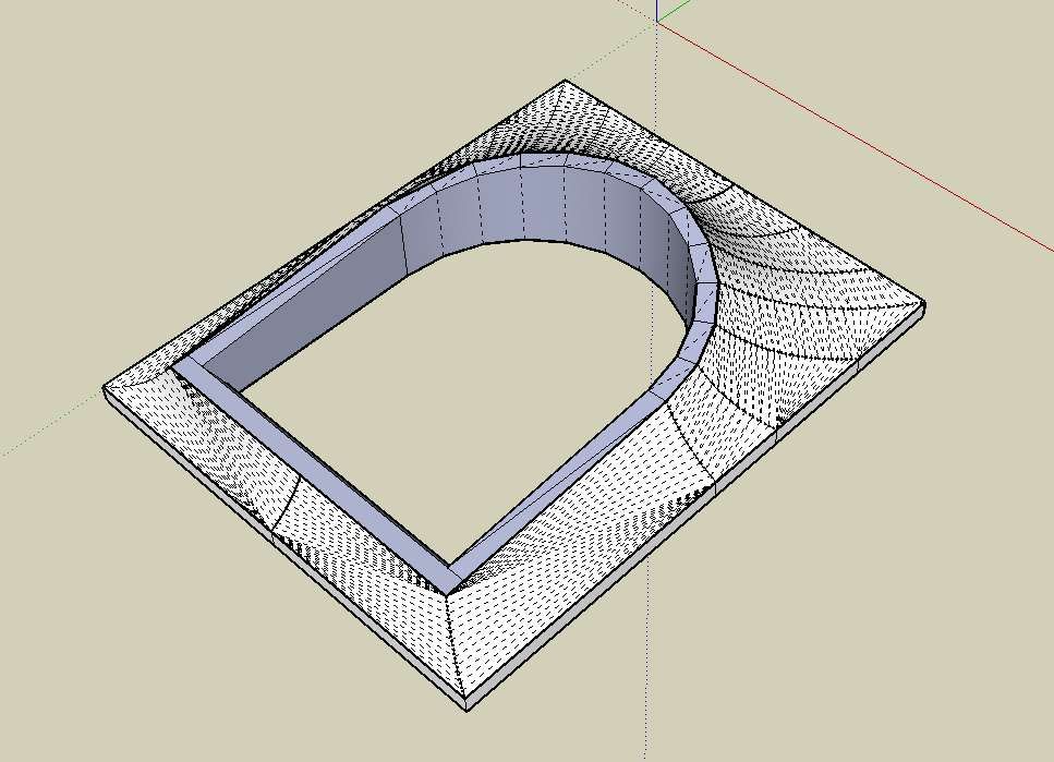

Here is my stab at this, with sketchup.

and into AC...
