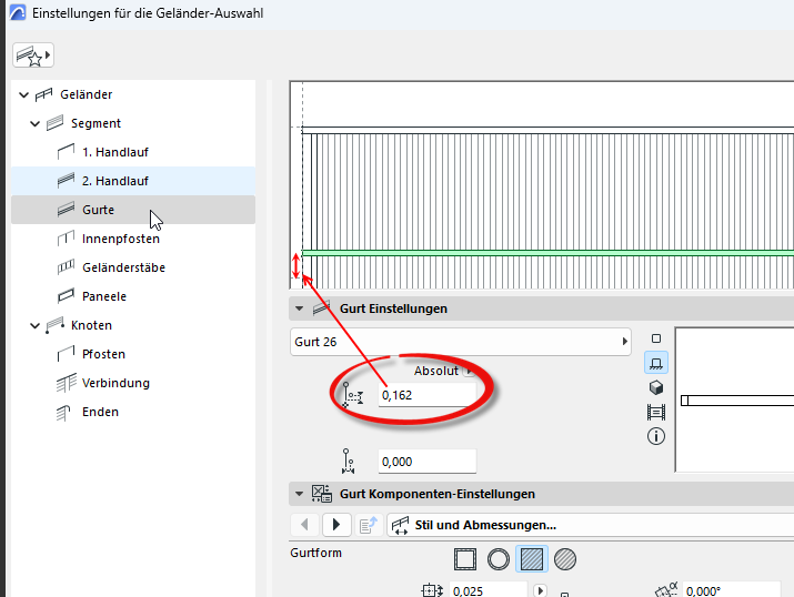

Does anyone  know how can I move this element of the railing down?
I don´t find the setting

I think you are looking for the first value in "Gurt Einstellungen". Try changing the value "0,162" to a smaller value. Is that what you were looking for?
