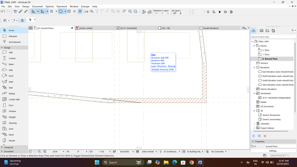

Intersection between concreate wall and brick wall in plan
HI,
I have been working on a plan in which i have made a brick wall and concreate wall intersection.
now i want to have a clear intersection between these two walls.How can i do that ??
thank you

HJ1
I have tried to intersect both of the walls... Both walls are in the same layer. But their materiality is different.
How did you make that junction of two walls?... I tried to do so... But it is still making such junctions only.
HJ1
No, there are not any other walls intersecting at that point rather than these 2 walls.
It seems the angle of the connection has an effect.

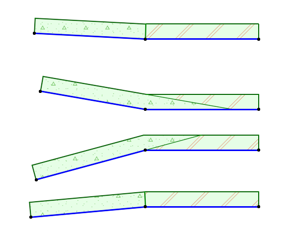

You can faux the connection with a really thin wall of the stronger Building Material on the bisector with the Reference Line on the inside. I made it 0.001 in the example below.
Ling.
Win11 | i9 10850K | 64GB | RX6600 Win11 | i9 11900K | 32GB | GTX2080TI
It is also possible to use Polygonal Walls for this connection, which lets you model the exact shape for both.
