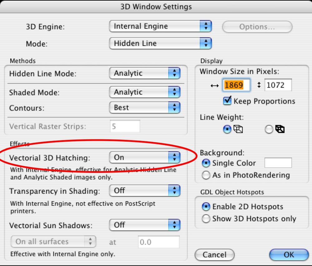

Wendy have you set the 3D window to show vectorial hatching?
Rod Jurich
Yup.

Wendy,
If you have the 3D window set to "OpenGL 3D engine" you will not
see the fill pattern only the texture. The same is true of renderings.
The only way to see the fill pattern in the 3D window is to set
it to "Internal 3D engine".

I do have it set to "Internal 3D Engine" - but I just realized I had vectorial 3D hatching turned off in that dialogue box. That's got it all showing up in 3D now, but still not in the renderings.
