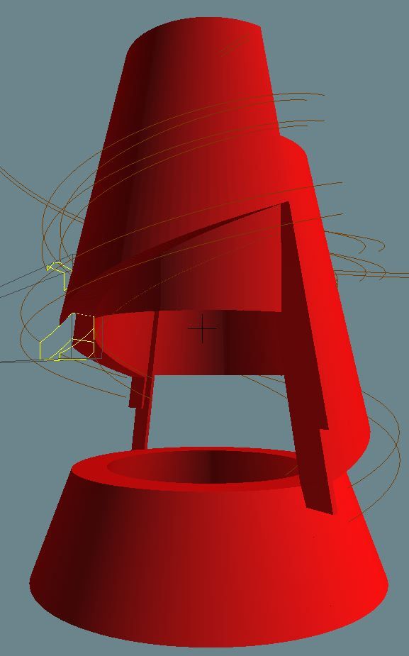

is there a way to design a spiral stair with solid side wall based on an oval shape?

Dwight, it does not cut the Wall with the Ramp for me.
Could you try it. Ramp object is attached.
Update: if the outer radius of the Ramp equals the outer radius of the Wall, it does not cut it. Probably because the Reference line of the Wall is on the outside and it thinks it is not fully below the Ramp.
If I decrease the radius of the Wall then it cuts it.
Update2: It also cuts the Mesh.
Most probably what happened is it did not works at the time I tried it with the beta version back then, and they fixed it since. I am pretty happy about that.
Sorry guys for the false alarm.

Hello Laszlo,
You wrote " I realized the reason is that the Ramp is made using the TUBE command in GDL which does not generate a solid body, only the surfaces of the Ramp."
In my experience, the TUBE command has generated a solid body since
at least as far back as AC 6.5. I have heard other people say that it only
generates a surface. So, as I said, TUBE generates a solid body for me.
Is it different for you ?
Thanks,
Peter Devlin
