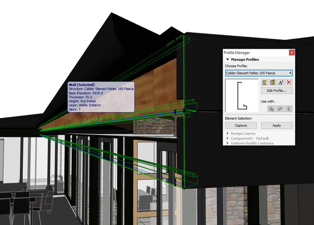

Fascia Profile not showing in 3d
I have created a fascia profile and applied it to a wall but now it is not showing in 3d, it was 1mm thick beefed it up to 4mm on the visible face to check it wasnt due to minimum visible thickness, but still nothing is showing
tried restarting archicad still nothing
See attachment
1 REPLY 1
Ok well I solved by own problem had to overide the core components the texture was defaulting to an invisible texture even though my original wall element already had a material applied to it it bacame invisibleonce the complex profile was attached to it, this is an annoying problem with the profile manager not using the default wall element materials
