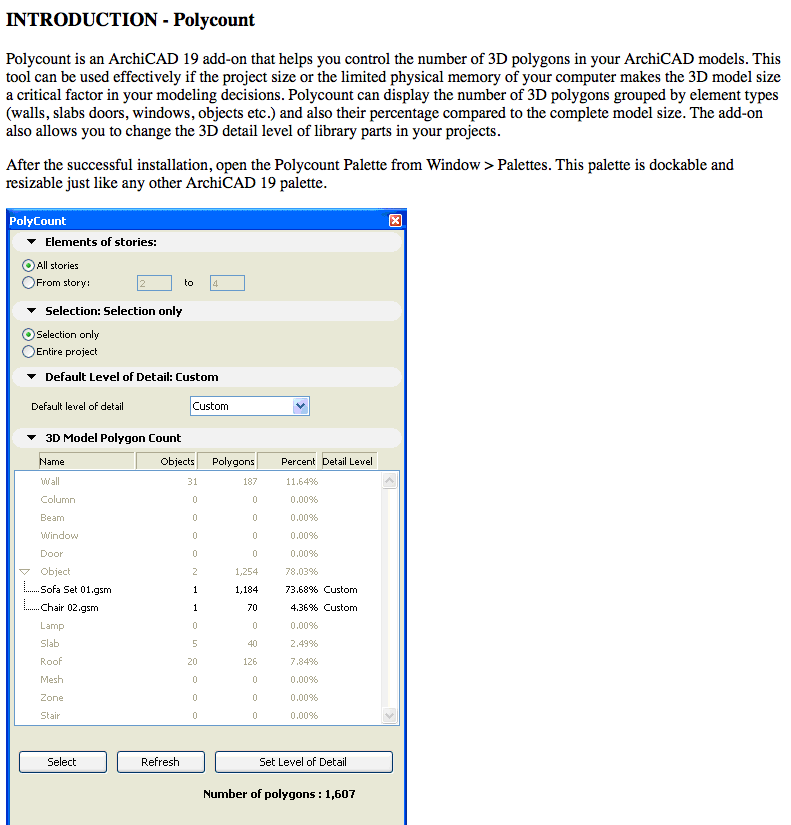

I'm not 100% sure this will answer your question..., but download the "Polycount" tool.
Archicad Downloads (from the help menu)> Add ons> Goodies
