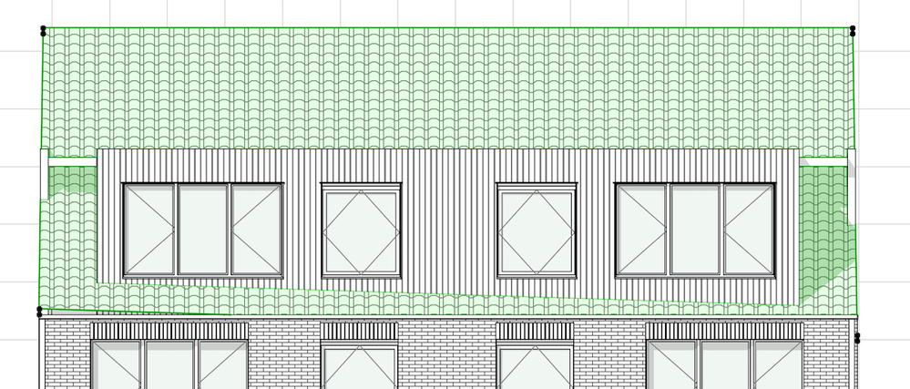

I have a problem with drawing a gable roof on a building with non parallel walls.
I draw the roof as a single plane roof.
Afterwards I connect them in the 3D window by clicking 1 plane, press the cmd-button (Apple user) and click the edge of the other plane.
I repeat this with the second roof plane. They connect perfectly.
The only thing is that the ridge is not 'straight', because of the non parallel walls.
Is there any solution? I've tried and tried many.
I've had contact with KUBUS. A helpdesk for ArchiCAD users in Belgium and the Netherlands. But even they could not help.
I hope someone of you can!
Many thanks in advance!

If you want the ridge to be level start with your single plane roof on the
wall that is not angled (top of your drawing). Mirror this as a copy to the
other side of the building and join them as you have been doing. Now you
will need to adjust the eave to be parallel with the angled wall. The eave will now have the angle to it, not the ridge.

I've tried this already.
Than the problem moves to the wall instead of the ridge.
I guess it's impossible to create a gable roof with a 'straight' ridge on a construction with non parallel walls?

On the picture you can see the building I'm drawing.
It's bingmaps, so it's not that clear.
Maybe there's still someone reading this that hopefully knows a simple solution.

I don't see the problem. There are only two solution using single plane roofs:
1. The ridge is parallel to one of the eaves and level, with the other eaves having a sloped wall top.
2. Both eaves are level and the ridge slopes down to the narrow gable.
From your comments I assume you want the latter. To do this draw your first roof parallel to the first eaves, then repeat parallel with the second eaves. You can then intersect the two roofs like this...

I think that your roof makes a ruled surface: the edges are not parallels.
You can't create a ruled surface with the roof tool... I suggest you to try using the shell.

I've drawn the single plane roof by using the Mesh Tool.
I installed an add-on so I could use the 'Create Roofs from Mesh' option.
In the end, I keep the roof with the ridge sloping down to the narrow gable, like DGSketcher said.
