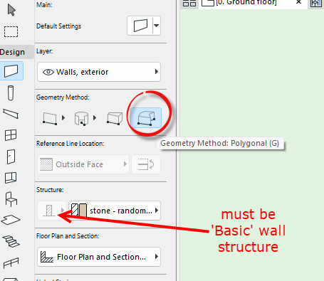

I assume by complex geometry, Mahmoud means 'Polygonal' wall geometry.
This can only be used with a basic wall structure, not with composites and complex profiles.
Friday
Exactly, I meant the polygonal wall, thanks Barry.
