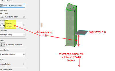

Hi David - Good to hear from you on this topic. It it was your advice that prompted me to work in the same way as you - which is now generating my tall earthen column when I generate perspective or axonometric views. I know that I can limit the heights by limiting the depth of sections elevations but I don't think that this is the same as creating a cut plane. Cut planes affect sections and elevations and often need to be adjusted to suit these views for, e.g. internal elevations and split level views. One can't have a separate cut plane for elevations/sections and perspectives - or can one?
It would surely be more convenient if Archicad had a command or setting that would limit the height of the earth column in 3D views without losing the benefits of preserving actual levels and datums in all drawing views?

Thanks David. I don't have the same Mesh picture as you. No 'Bottom and Top', no 'Mesh Skirt Height (T)'. I try to show a picture of what I have.

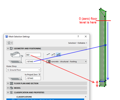

Mesh Skirt Height being the distance down from the Mesh Reference Plane to the bottom of the mesh is the 1000 in your image.
You might be able to put something like -175000 as your value for it to offset it upwards above the Mesh Reference Plane given your terrain difference is less that 12.5m.
Ling.
I had a look at this again and what I said won't help you in your case.
Because you seem to be modelling your building at 0 (zero) floor level, and are setting your mesh reference line down at sea level (1187440) and then setting the heights of the top points to their true height above sea level (hence the tall mesh), you won't be able to control the skirt height as I suggested.
You can make it deeper (adjust the figure (860 shown here) or drag the base with the pet palette - height option.
But it can only be moved up to the reference line (zero skirt height) - it can't have a negative value to reduce the height of the mesh above the reference plane.
The only way to hide this height is to limit section and elevation heights and to use a cutting plane in 3D as mentioned before.
Otherwise, set the mesh reference line to 0 (zero) but this will lift the entire mesh up higher.
Then you will have to adjust the height of every top node down by 187440 in your case.
This can be done in 3D with the pet palette with 'Z' height option.
Drag each node down and type ... 187440 ENTER.
If you don't have too many nodes this will be fairly easy.
If you have a lot, it will be rather tedious.
"But it can only be moved up to the reference line (zero skirt height) - it can't have a negative value to reduce the height of the mesh above the reference plane."
AC25 thing? As it works fine for me.
Ling.
Actually you can if you type the figure in the mesh settings (info box).
It seems you can't drag the base in 3D above the reference plane which is what I was trying.
So, @KeesW , if you type a figure like this in your mesh settings, it should look a lot shorter.
