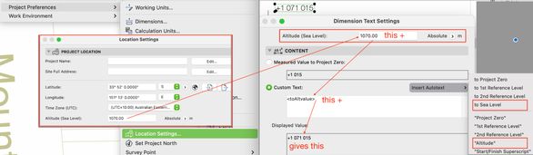

David Shorter
Project zero is the base level for the project. Its actual starting position in space. The zero level position in Archicad.
Sea level and Altitude (<toAltvalue>) are relative levels which don't change the position of the model in space but allow level annotation to reflect these references.
Altitude (Sea Level) is set in the Work Environment under Project Location (see below)
Thats the good news.
Unfortunately.....
1) Altitude can only be set in meters, which is NOT Australian Standard for Levels.
2) And this is the killer......
These settings cannot be used as the default when placing levels using the Level Dim Tool. So when placing a spot level using the Level Dim tool the Text part must be selected after placement, the setting changed to Custom Value and <toAltvalue> selected. Its makes this method unworkable. A medium site model my have 100+ spot levels and to select these manually to show the correct level is not practical.
