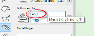

I prefer using real RL's for floor levels (as recommended by Graphisoft) and am modelling a house on a steeply sloping site with ground level about 180m above sea level. External 3D models therefore default with 180m high columns of earth under the ground floor. Just as well I am not building on top of Mt Everest!
I can avoid this by modelling with nominal levels - say ground floor at 5m (to allow for the slope). Archicad examples conveniently model their examples on flat, or nearly flat, sites floating near sea level which entirely avoids this issue. Is there a way to use real RL's on high sites without generating this problem?

Try just adjusting the skirt height of your mesh.
It can also be dragged in 3D with the height option in the pet palette.
