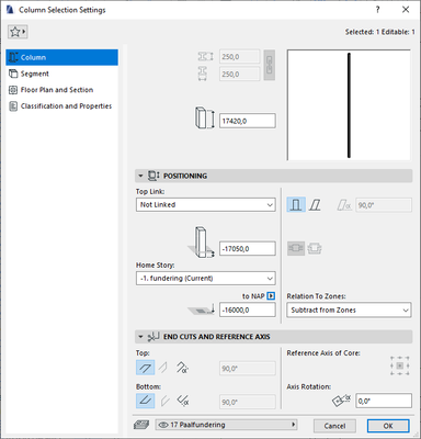

2022-03-16 01:32 PM - edited 2022-03-16 01:37 PM
No idea if this helps with Australian standards, but we use one of the two 'reference levels' for our equivalent of 'sea level' (NAP, Normaal Amsterdams Peil). You can even rename these so you know what you are using in your project (NAP again in our case) and you can change the text in level dimensions to show dimension to project zero and to this custom level.
They do work in your working units, but then again so do floorplan levels?
It is not uncommon for the preferred 'level' of the project to change when we get closer to construction and it is just a matter of adjusting one field in project preferences and all dimensions are automatically correct, except for ussually the foundations, but those would have to change (logically).
Sea Level would work much the same, but we can't rename this field. In case it matters for IFC export, we do fill out Sea Level the same way though.
The settings.
Example of level dimensions.
Example of being able to set elements in relation to level.
2022-03-16 01:39 PM - edited 2022-03-16 01:43 PM
One more addition, sometimes we need to show this value in meters, instead of milimeters. For this we've made a custom property with the following script:
STR ( STRTONUM ( STRCALCUNIT ( {Property:General Parameters/Elevation to NAP} ) ) / 1000; 2 )
Edit: this returns a string (text) value so it stays the way we want in schedules and such (doesn't change formatting based on other numeric rules in the project).
Here's a sample text we place on layout that shows the project level in meters and the level in meters for the pile foundation parts.
If we change the level in project preferences, these values will update automattically.
